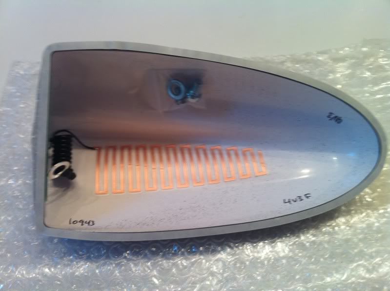

Essentially the SF is replacing the whip antenna with the printed circuit plane antenna shown below.
The ground plain is the base that the whip screws in to.
The instructions are clear that you should not let the SF touch the original base since this will short out the antenna and ground plain and you will have no reception.
The loss in signal is probably due the the printed circuit antenna shown in the picture is not as efficient as the whip. Also any metallic paint will tend to shield the signal and prevent optimum reception by the antenna.
This Shark Fin is a compromise. To get optimum reception with a sleeker design would require major roof surgery and paint job.

The Shark Fin has been on my CT for three weeks now and I haven't noticed any difference in reception at all. If there is a signal loss when compared to the stock whip antenna, I would wager that it would be so minimal that it could only be determined using an electronic device that measures signal intensity.
