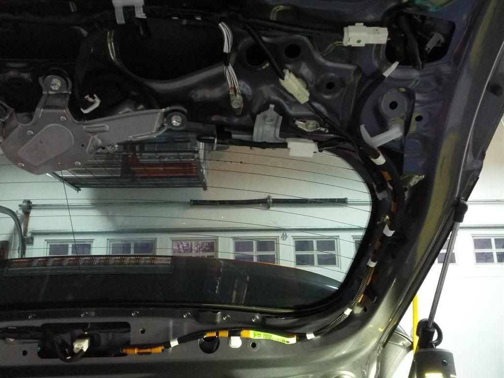

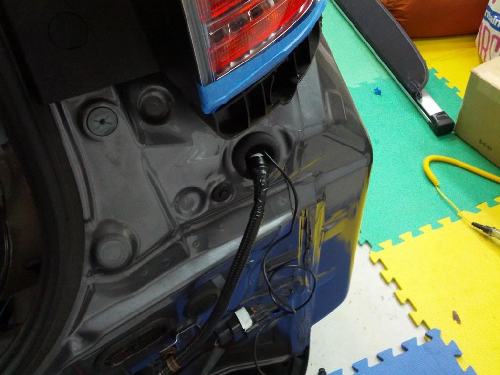

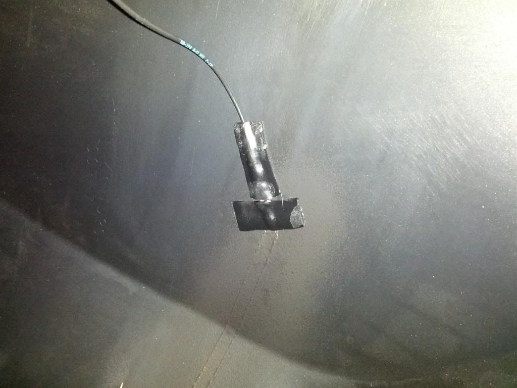

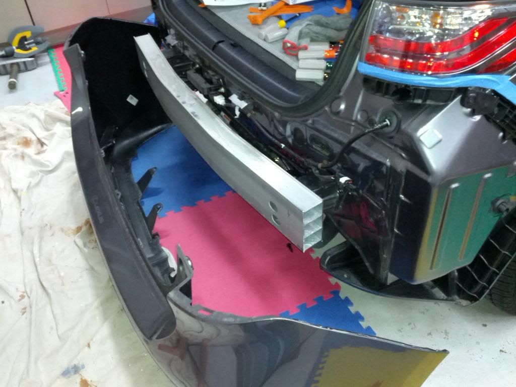

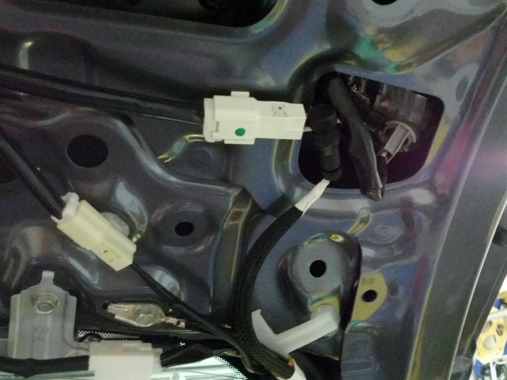

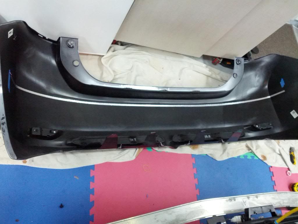

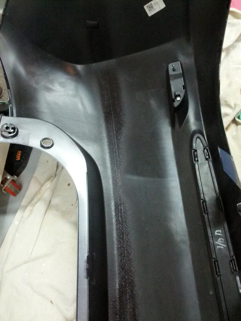

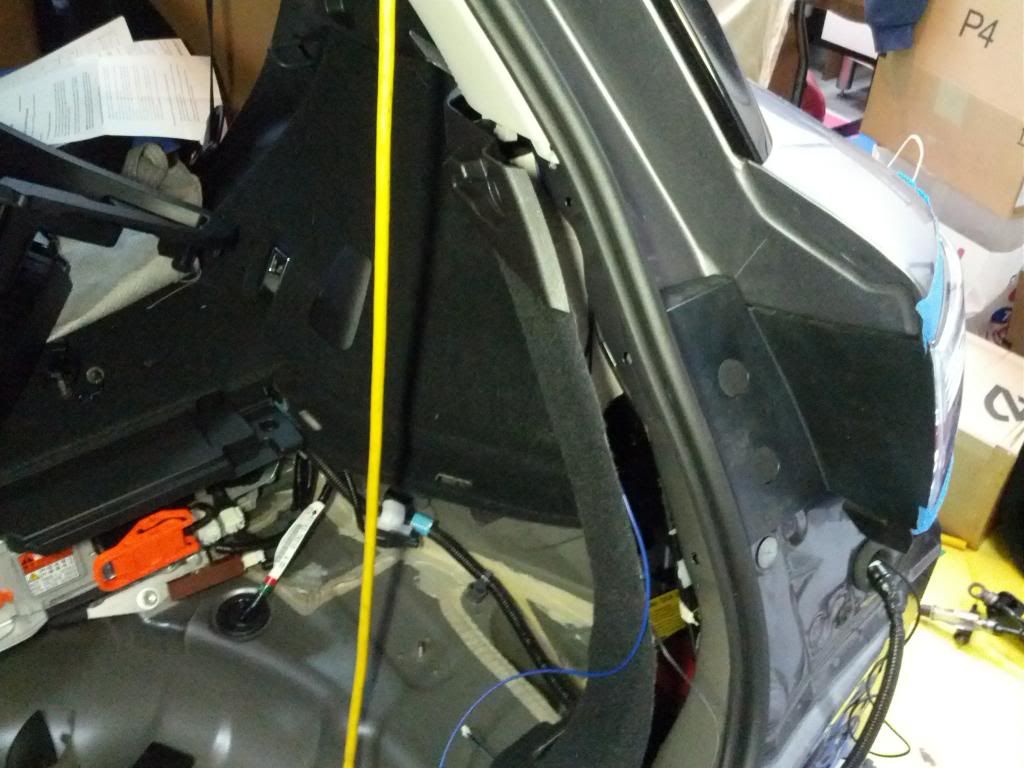

Install wasn't bad, trickiest part was removing the bumper and feeding the power wire through the hatchback boot. I hid the beeper sensor behind the grill section next to the rear trunk light. It's accessible by removing a few screws and popping part of the rear carpet liner. I also used a 3M spray undercoater to cover the stick on metal sensor to help potential weathering or de-laminating.

Install took me about 2-3 hours, because it was my first time taking off the bumper and I didn't understand how the clips worked that held onto the bumper at the sides. I also didn't realize that the reverse lights were in the hatch and not the side taillights (stupid me). If I were to do it again, it would probably take me 1 hour from start to finish.
