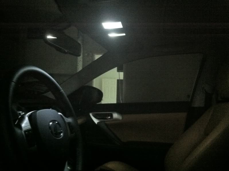

Hey guys I'll post pics but one MAJOR problem. Even the guys at superbrightleds.com are stumped. The cargo area led festoon bulb is too long! It won't fit in the socket for the CT. I actually bent the tiny metal bracket/spring that holds the current tiny halogen bulb. Major bummer as that crappy light doesn't really light the cargo that well at all. I asked the led light company if they have anything else smaller and they don't. Any solutions anyone???!!!
Ok guys here are the pics. I have one issue with the map lights the color is slightly different than the other which I'm addressing right now with superbrightleds.com The kelvin temp is off. Typical with cheap Chinese made LED's but, I'm not to stressed out about it. I'll try another bulb but the LED's are a MAJOR IMPROVEMENT over the stock weak yellowish halogen bulbs the CT came with well worth the switch out!

CT Surfer: Looking good. I used a 3022 Festoon 4 LED. Mine is not super either, but it looks ok. I had to put it on a slight angle to make it fit.
