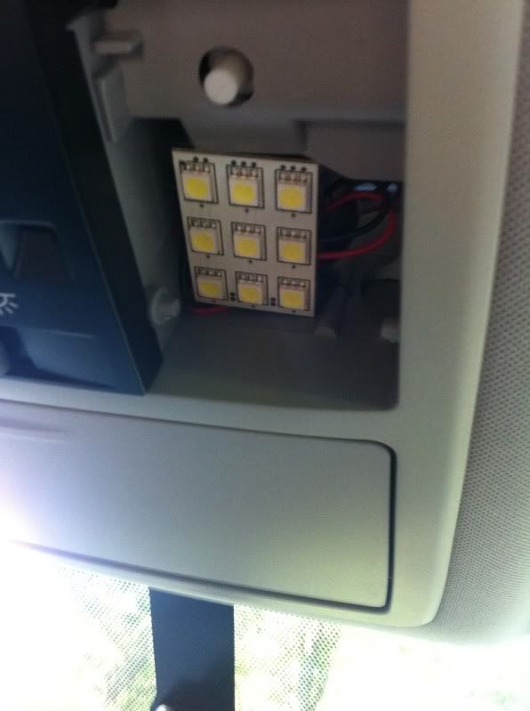

Below is a brief "how to" for replacing the map lights with LED smd's.
Hopefully this will help people and show how easy this replacement is.
As usual remember the polarity of the connection has to be correct or the LED's won't work.
I also wanted to to increase the brightness as much as possible so I replaced the wedge bulbs with flat multiple LED's.
The map light pops off with the aid of a plastic spatula.
The hardest part is removing the wedge bulb.
A 9 led smd fits nicely inside the lens housing.

First thanks for all of the how to docs for these replacements. I've completed interior LED replacements for all the lights except for the map lights. Any additional details on how to remove the wedge light bulbs. Tips for things that have worked for others?
I tried to pull straight down on the lights with as much force as I could put on the light bulb without fear of breaking it. Neither of them seem to be giving, maybe someone with small fingers?
Yes getting a grip on the glass can be a challenge. A piece of rubber tubing pushed over the bulb may give enough grip then the bulb pulls straight out - no twisting !!!

I had exactly the same problem and after trying in vain to remove with fingers alone I put a small loop of sticky tape round the bulb with a short "tail". Steady pull on the tail and the bulb came straight out really easily.
Hope this helps

Most SMD's come with appropriate connector to "plug in" to original bulb connector
