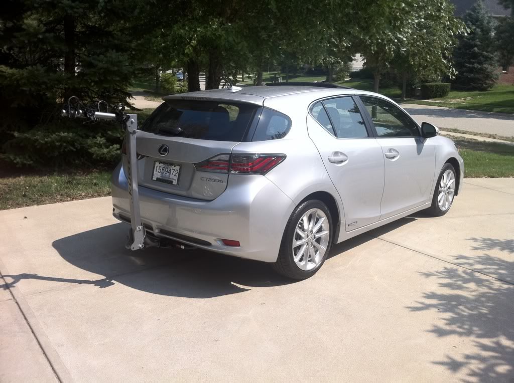

Thule Helium: 26 lbs.
2 Road Bikes: 50 lbs.
Hitch Weight: 23 lbs.
Total Weight: 99 lbs.
Being able to have wifey easily attach Thule bike rack and load both bikes....
Priceless!!!
I think you should reward your CT with some sub-20lb road bikes now. :p

I had the Curt hitch installed yesterday. Used a professional hitch company to order and install. It took them about 20 min to do it, so it must have been easy. It looks pretty good. Not as good as no hitch, but not too bad either. Need it for bike rack.
So, I installed my hitch this evening no problems. But, I am running into a problem. The pin that came with the hitch doesn't fit. On the passenger side hole for the pin to go through is smaller than the pin. The hole on the driver side is fine and I can get the pin to go through. But, the pin is too large to fit through the hole on the passenger side. Can somebody please check to see if the pin hole on the passenger side is smaller than the driver side? I want to see if I got a defective hitch or the pin that came with it is wrong.
Any time I look at a used car with a hitch receiver I move on to another one without the same. Towing and using a hitch for other accessories puts a lot of stress on the vehicle. The engine and transmission have to work significantly harder and the brakes and suspension take more abuse. Even a light weight utility trailer without a load puts a great strain on the vehicle. A bike rack induces a pretty significant moment arm load on the vehicle's under carriage and structure. I think all of these reasons are why the car manufacturer does not recommend using it with a hitch. It'll definitely work for you but be advised you're asking for trouble and will likely take a hit at time of trade-in.
My Curt hitch did not come with a pin. I'm using the pin from my Thule rack.
Mine came with a pin and a draw bar. I use mine for a bike rack. But, when I don't use a bike rack I put the draw bar and ball on there to prevent people from bumping my bumper when parking. I live in Chicago and city parking takes it's toll on cars. It has saved my rear bumper on previous cars. I am frustrated that the pin does not fit and calling etrailer where I purchased mine from to see if it was just a fluke on mine.
If anybody has a pin that came with their hitch, could you please see if it fits?

Yeah.. I'm not worried.. ;) My Curt hitch is arriving today... Just was curious what his answers would be... R
The KUAT (bike rack) people sent me a locking hitch pin for 19 bucks. I like your idea to keep your bumper safe, but it must add a certain degree of ugliness to the machine. :)
True, it doesn't add to the beauty of the CT rear end. But, I rather have a ball back there instead of a license plate screw indentions on my rear bumper.
I called etrailer and they said that it could be a buildup of powder coating and to file some away. Otherwise, they would be more than happy to send me a new one. I'll try to see if the file trick works. I just don't want to remove and reinstall a new one.
