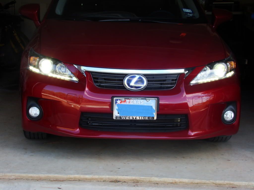

They should match, I have them as fog lights but halogen won't be near as bright and crisp as HID. Even though I have and am currently having problems with DDM HIDS I still think the HIDs look much, much better and light the road very well at night. I am replacing my DDM HIDs with Kensun which are scheduled to arrive today. I had water get in my left fog housing after heavy rain and driving through water so I reordered some more Ultra Silverstars., I will post some pictures and you can see better how the Ultrastar matches the DRLs. Bleow is a picture with 6000K DDM; I am going with 4300K Kensun which will match DRLs and fog. Again in the picture the blue tinge of the 6000K overdrives the DRLs and the Sylvania ultrastarcuasing the hint of yellow appearance, while the 4300K I am getting will match perfectly and there won't be the hint of yellow.
In the picture ignore the HID lights and just compare the DRLs and fog lights.

Here is a shot that show the difference between 6000k and 4300k. I installed the passenger side first, driver 6000k. I thought it would show better. Oh well! But if you look close the driver's side is bluer and the actual light makes the DRLs look yellow.
During installation, the DDM relay harness failed. I have had it with DDM products and had to unistall the relay harness. The ballast on the Kensun are slightly larger than the DDM.
So far, great the Kensun looks like a winner!
