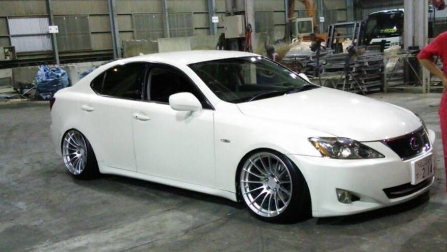

I just recently purchased a 2011 CT200h. I love it but think that a nice pair of wheels would really make it pop. Does anyone know if the Enkei RS05RR wheels would fit? This is the size that seems closest to what others have put on their CT's. 18x8.5 5x100 (42mm Offset / 66.5 bore)
(Seen here on an IS)
I would really love a pair of these wheels but if they don't fit I will need to look elsewhere i guess.

Should fit. you would need a lugcentric adapter 54.1 to 66.5. Currently im running 19x8.5 w/45 offset. I think the 42 would sit just right on the front and should clear just fine. Some folks here have pushed 35 offset.
