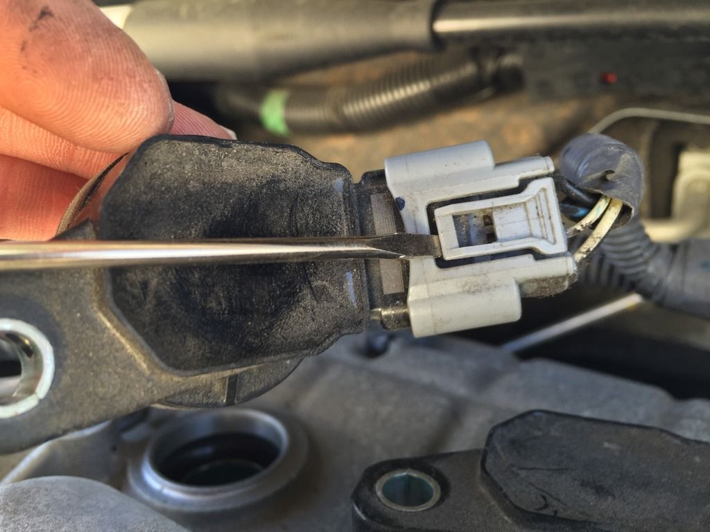

Just did mine as well. I had to buy a 14mm spark plug socket from Amazon. You will need a 6" wobble extension to clear the cowl. A straight extension won't work.
i also had trouble with disconnecting the connector from the ignition coils. I had to use a small std screwdriver to help lift the retainer while I pushed down on the opposite end.
