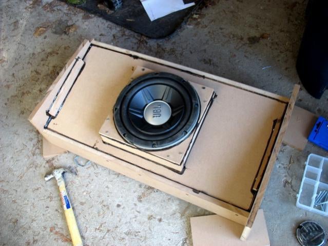

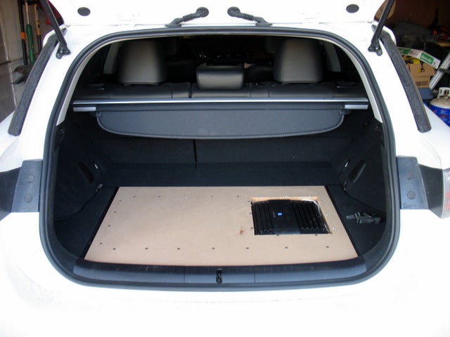

speaker: JBL 1014D
amp: Alpine MRP-M500
enclosure was built with 5/8" mdf. fits over the spare tire. completely hidden under cargo tray when done. amp is pretty sturdy so i left it uncovered under the cargo tray. this way i can tune it when necessary. might cover it with a metal grill later.
sound? not bad for a single 10". can thump pretty hard when the gains are turned up. can actually make the car rattle a bit. but that's not what i'm going for. i have the gains set about 2/3 way up. gives a nice low end for normal listening.
LPF set to 80hz. HPF of front speakers set to 60hz. overlap makes the bass seem to come from the front.
amp has a subsonic filter at 14hz.

That's a really sweet box. I'm not too sure about firing the sub directly into the spare tire though, that probably explains why it's not giving you the response that you wanted. For hatchback cars a box pointed back at the hatch seems to give the best response, but then of course it's not stealth at all and takes up a good deal of space.
